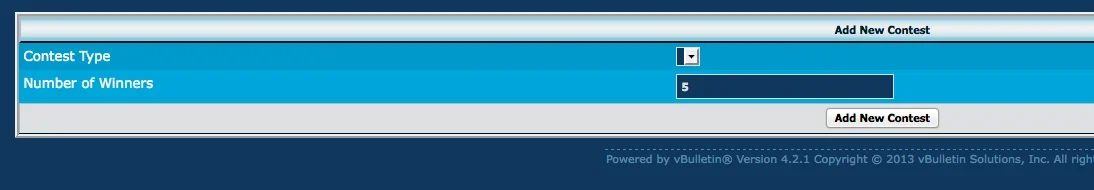

I am trying to setup my first contest but for some reason the options doesn't show properly on my admin panel. See screenshot.
I tried already to rebuild the cache but it didn't help

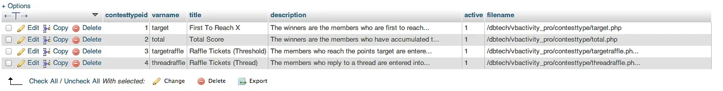

Please check the contents of the database table dbtech_vbactivity_contesttype - it's possible you've got a data corruption.

Sorry for taking so long to get back to you, I've corrected this issue on your site and in the live release package :)
Couldn't report back as we moved our forum to a new server and no chance to test it out.
Today I uploaded the new release and it works perfect now.
Thanks for all the help
