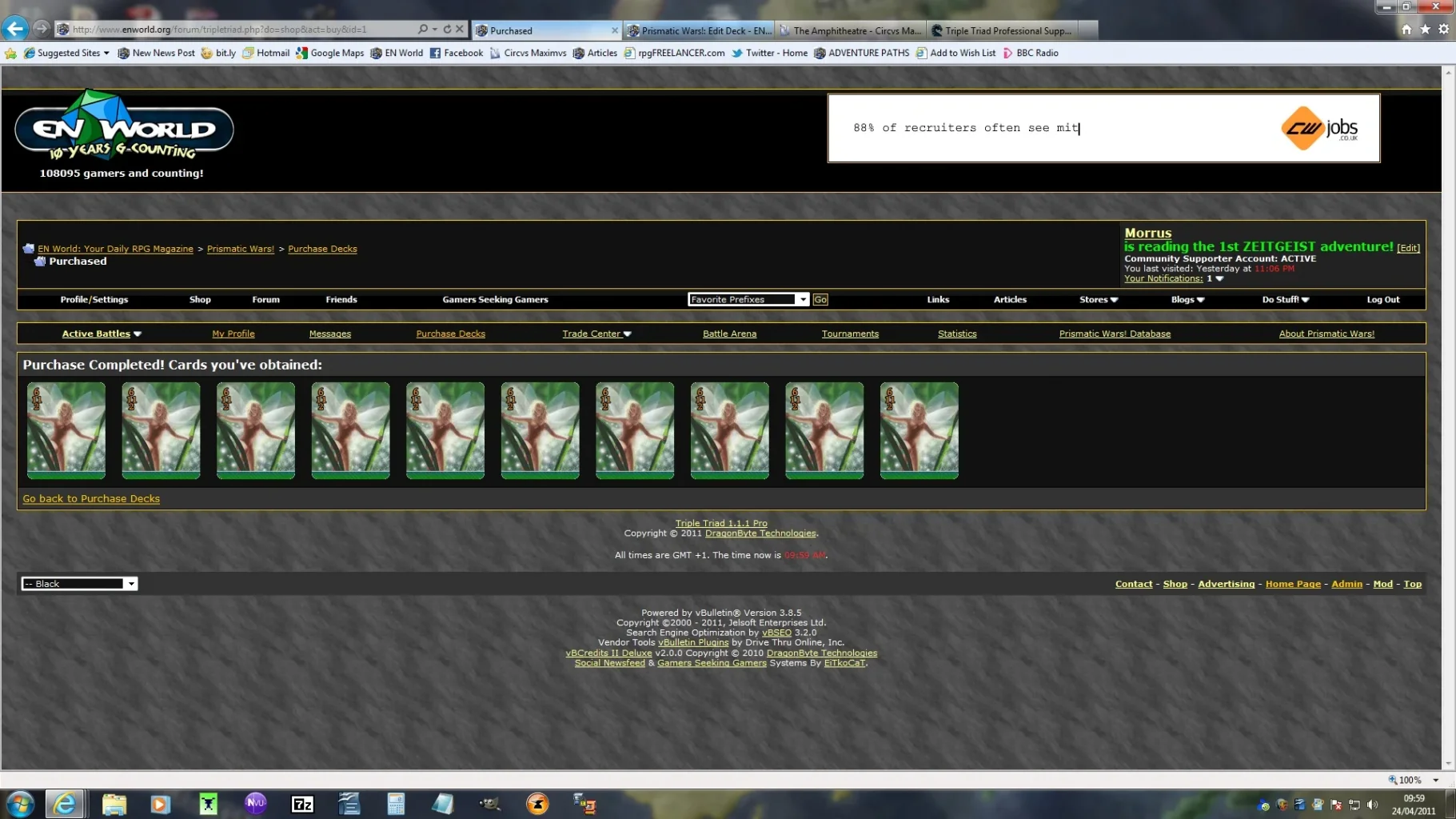

We've run into a weird issue.
We have a free starter pack set up. It has the following settings:
Random Cards: 10
Chance for Level 1: 1000
Chance for Level 2: 0
Chance for Level 3: 0
... etc. with 0 set for all chances except Level 1
Deck Cards Handout: None
So that should hand out 10 random level 1 cards.
The level 1 cards from that deck are set up as follows:
All Rare % set at 0
Except for one card ("Xia") set at: 800
So as far as I can tell, it should now hand out 10 random level 1 cards from that deck, with Xia appearing only rarely.
However, what's happening is that every starter deck is 10 identical Xia cards (see screenshot). I'v pored over the values set, and can't figure out any settings area on my part, so I'm guessing it might be a bug.
As an update - changing that card's rarity from 800 back to 0 has made the spread random again. So it seems that the inclusion of a rarer card in the random deck causes the system to choose only that card.
Is it possible that the rarity % is reversed in the code (so 0 is actually rare and 1000 is actually common, as opposed to the descriptive text which says the opposite?)
0 means none of those cards will come out, 1000 means there is a 100% chance of those cards coming out.
I'd recommend using small values first, it may just be that the 800 is so high the system is hitting it every time before it can progress to checking the next level.
Try changing the settings to 100 and 80 instead of 1000 and 800, see how that works out for you.
EDIT: I just remembered that they system prefers the TOTAL number to be 1000. e.g if you wanted to have an equal chance of level 1 2 3 and 4 you would set it to 250 each. - Try changing the numbers to maintain the ratio you want, but have the total equal 1000 =)
