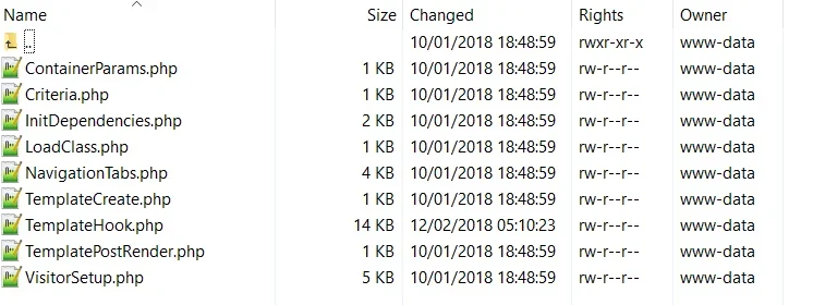

i thought maybe EventListener? but it doesn't look like there are a lot of stuff in there:

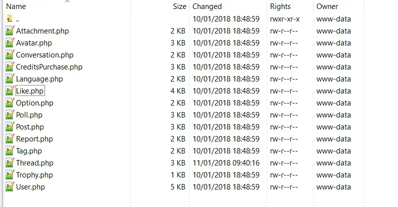

is it maybe in "Model" ?
I tried looking at those files but they dont make any sense to me:
I wanted to look at XFCP_DBTech_Credits_XenForo_Model_Like (red rectangle above) to understand what that class is, because a lot of calls in that file are calls to parent::something(), but I couldn't find class "XFCP_DBTech_Credits_XenForo_Model_Like" anywhere in the source code on the entire server (how is that possible?)
