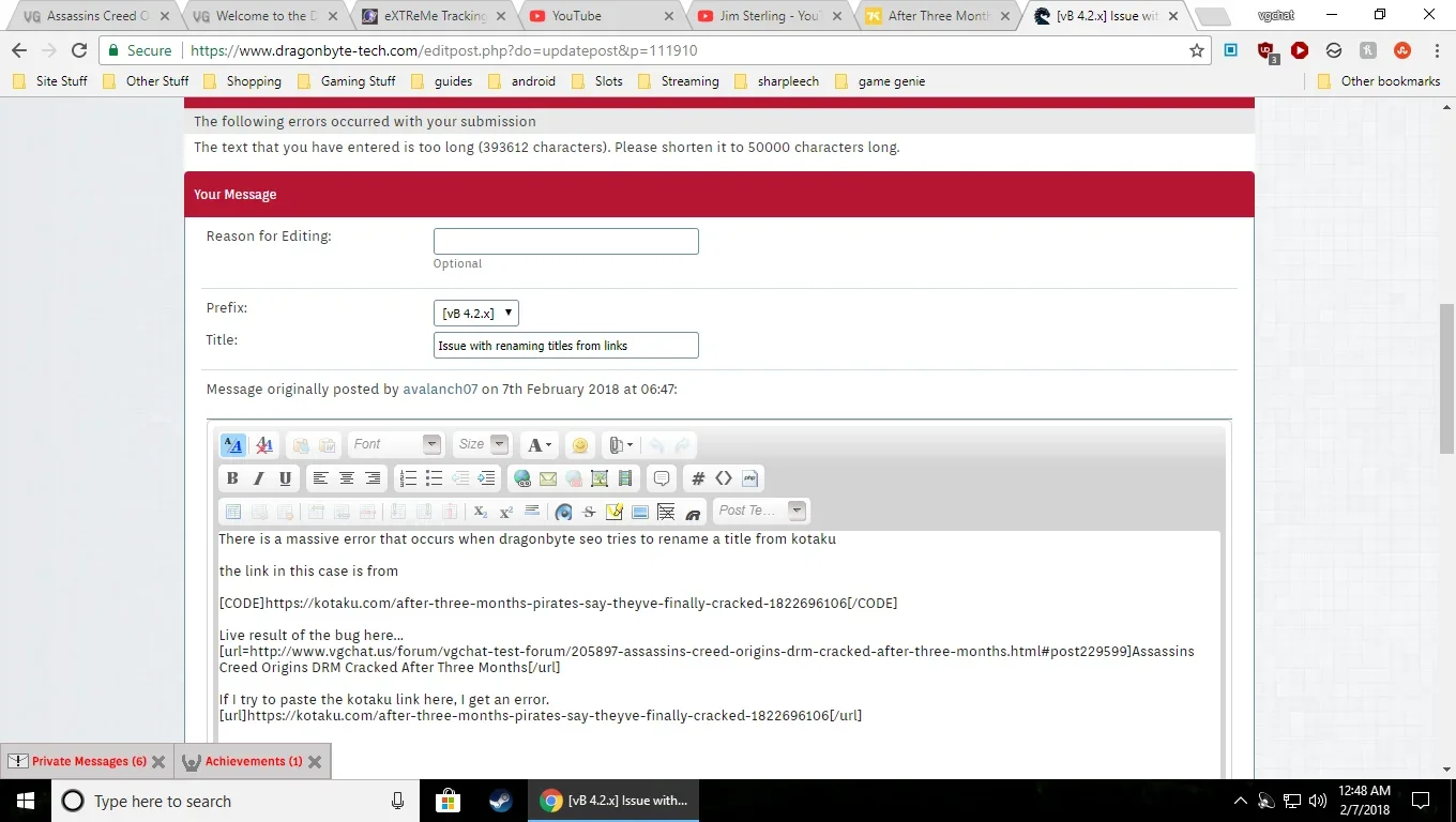

Bug Issue with renaming titles from links
This is mostly a problem with Kotaku's site. If you view the source code:
view-source:https://kotaku.com/after-three-months-pirates-say-theyve-finally-cracked-1822696106
then search for
<title>
you will find title tags inside some of their JS code. This is not the correct way of creating a website.
The issue is that because they have multiple <title> tags in their code, nor formatted correctly, DBSEO captures everything from the first <title> tag to the first valid closing </title> tag.
I'll see if I can work around it, but I can't guarantee I'll be able to.
Thanks for the update Fillip H.. If you can't find a way to fix it properly, I suggest adding a blacklist option for sites to skip the parsing of titles from.
Let me know if there will be at least a blocklist please. It looks like many "sister sites" of kotaku also do their titles that way.
about 13 others in total including lifehacker & gizmodo
There won't be a blocklist and I've not been able to work this out, so if your site frequently links to these sites you should disable the link feature, sorry.
