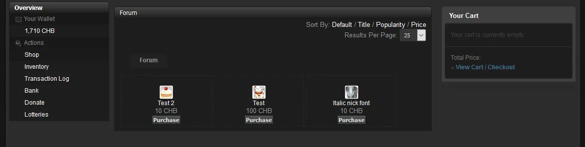

Hello, so yesterday I bought and reinstalled the vbshop product on the site, everything is installed properly and the other options work, but there is a problem with buying the items. So I created three test items of different type and when I try to buy them by clicking on ‘buy’ nothing happens. The item is not added to the cart. I checked the permissions and settings of the shop and everything seems to be fine, but for some reason there are no details about the item when I hover the mouse over the item and it is not possible to add the item to the cart. Do you know what the problem is and how I can solve it?

Can you try it in a default (unmodified) style with no other add-ons enabled?
I tried and it works in the default style, meaning the problem is somewhere in the custom style. But like I said I reinstalled the product. So before that there was an older version of the product on the page that worked with that same custom style and there was no problem with buying items and hover item info.
I solved the problem.
The problem was that in the footer template there was another jQuery script src for something else, when I removed it everything was fixed.
Thanks for showing me where to look for the problem and quick answers.
