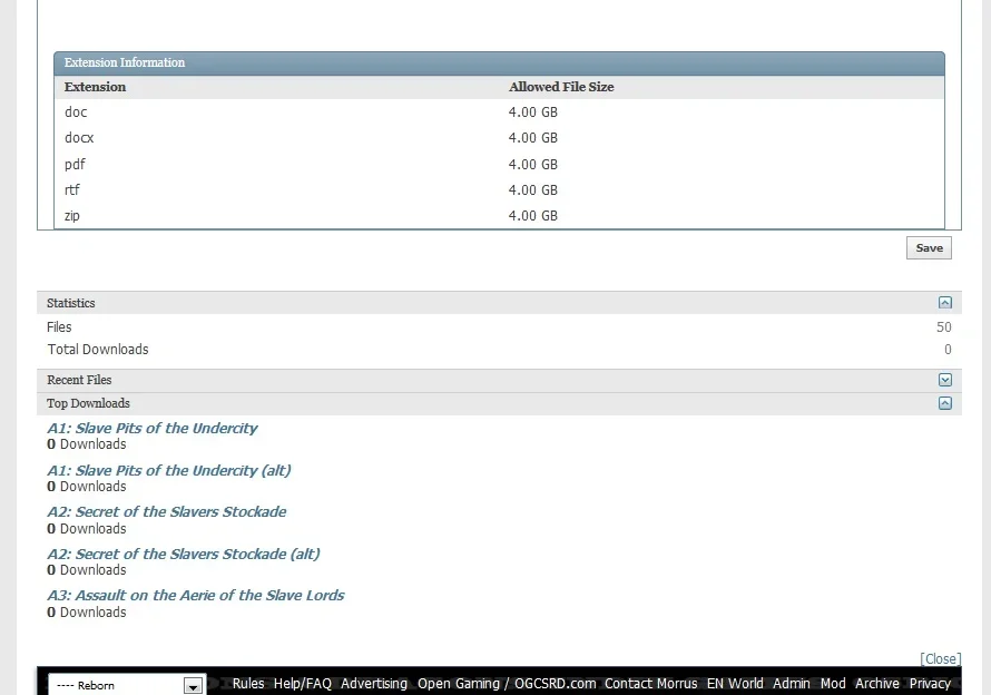

The sidebar isn't a sidebar. The contents all appear at the bottom of the page instead. Screenshot attached.

The issue is most likely that your vbulletin_css directory is not writeable. You need to CHMOD it to 0777, then go into your vBulletin Options -> Style & Language Settings -> Store CSS Stylesheets as Files? to No then switch it back to Yes.

The vbulletin_css director is set to 0777, so that's not the issue.

Please try the above steps even if your directory is already CHMOD'ed.

I did the settings switch anyway - didn't help.

The reason for this issue was the fact that the Owner / Group of the files & folders within the vbulletin_css folder were mixed & matched, possibly due to a server move.
I turned stylesheets as files off, SSH'd into your server and removed all the files & folders in that directory (except for index.html), then turned stylesheets as files back on.
It is now working correctly, and should work correctly for future modifications.
Wow, that's complicated stuff I'd never have been able to figure out. Thank you! Everything looks great now!
