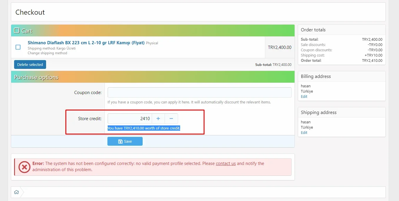

I bought the dragonbyte e-commerce plugin to use with the credit plugin, but I think it is not compatible with the credit plugin as a payment method. This is a big problem for me, I demand a solution on this issue. I bought the Dragonbyte store plugin, but the plugin is extremely useless.
why can't I get the product with this credit when I add store credit to the user?
It is. You have to add DB Credits as a payment profile, then add it as a valid option in DB eCommerce settings.

I'm getting the user to buy the product by adding store credit, but the notification doesn't come.
What notification?
if you can pay with dragonbyte credits, dragonbyte ecommerce, that's fine. I guess I couldn't do it, I'll try again and report it.

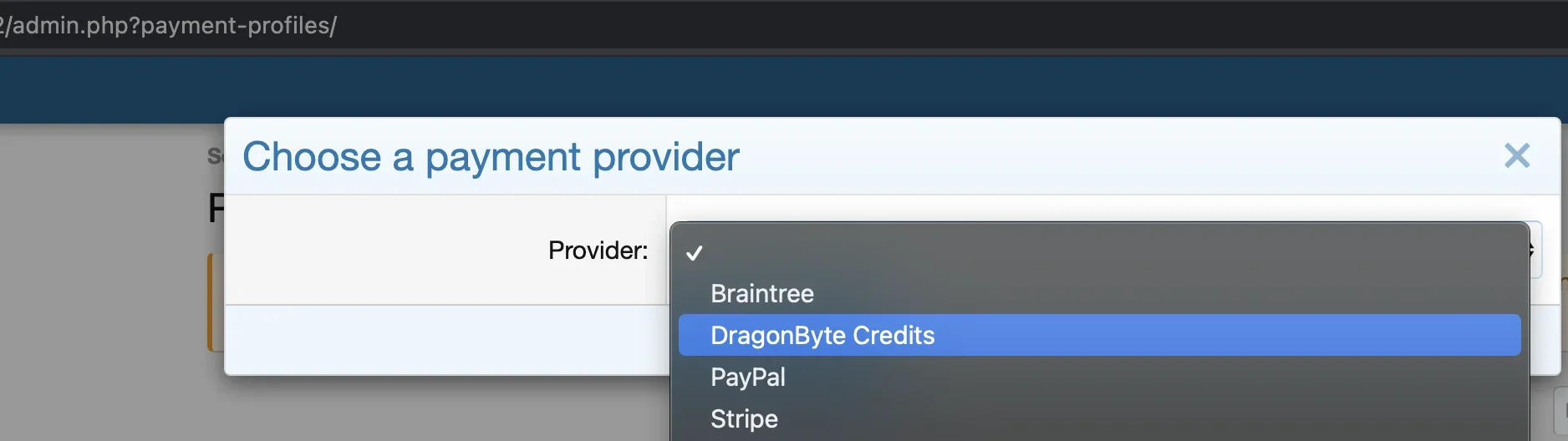

Yes, you can use DB Credits as a payment profile:
Do not that it will not transfer the credits from the person who bought the item to the person who is set as the item owner in DB eCommerce.
I wanted to do this so that members could buy products with dragonbyte credits.
Thank you so much.
Step 1: Go to admin.php?payment-profiles/ and click "Add payment profile"
Step 2: In the "Provider" drop-down, choose DragonByte Credits
Step 3: Fill out the form. Make sure you read the description for the "Exchange rate" field thoroughly, as this is very important.
Step 4: Click "Save"
Step 5: In the left hand menu, click on "DragonByte eCommerce" to expand the menu
Step 6: In this new menu group that just expanded, scroll down and click "Settings" (admin.php?options/groups/dbtechEcommerce/)
Step 7: Scroll down until you find "Available payment profiles"
Step 8: Tick the box next to the payment profile you created in steps 1-4
Products will now be purchasable with DB Credits based on the exchange rate you filled out in step 3.
