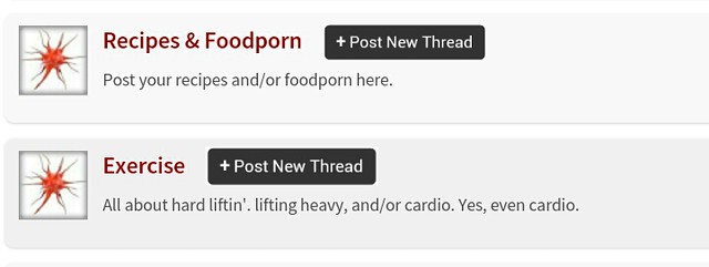

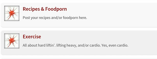

So, to be clear, using these two forumbits as examples, I'm wanting to take my forum homepage from this:
To this:
Or this:
This is a vital part of a #trifecta request which will largely make the idea of the forumdisplay template obsolete, which is a good thing. It could revolutionize the way vBulletin is navigated, posts are made, and information is discovered, using other fine Dragonbyte Tech mods such as Live Feed and hashtag support.
Please and thank you.

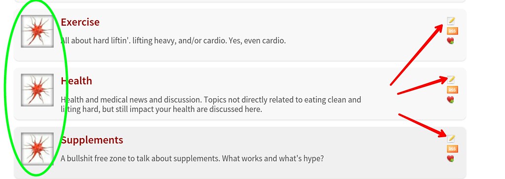

Here's how it looks (red arrows, obviously):
Unfortunately, without me beating people over the head to remind them that they can click on the pencil/paper icon, people aren't likely to remember they can do it. It's such a small and relatively non-nondescript icon that people will forget about it and what it does. I'd also have to point it out to each new member that signs up, too.
I'm guessing that having larger buttons (which would open up the capacity to be more explanatory) that are placed more toward the left side of the forumbit - like I was illustrating in my first post above - is prohibitively difficult or impossible to do?
If so, let me present you with this: Those buttons in the green circle in the picture above...they don't do anything when they are single-clicked. Double-clicking them will turn them from green ('green' meaning that forum has new posts) to red ('red' meaning the forum has no new posts/has been marked "read"). But single-clicks do nothing to them. Is it possible to arrange it so that single clicking those buttons will act as a link to newthread.php for that forum? Even if it meant that the double-clicking function would have to be disabled, I'd be ok with that. I have other ways people can see if new posts have been made, such as checking in with your awesome Live Feed mod.
If single-clicking those buttons to open up a new thread can work, then I would simply change those buttons from what they are now to the words "Post New Topic" or something to that effect.
THAT would be awesome. Even better than what I had imagined in my opening post, actually.
