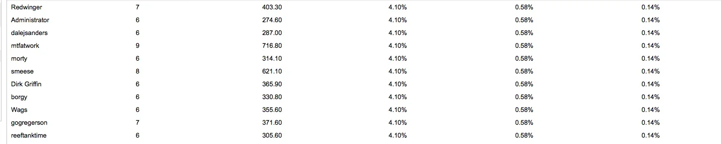

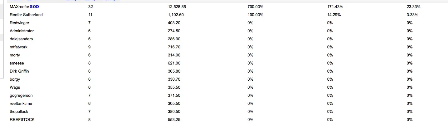

However as you can see in the screenshot some users have very high activity levels. How can this be as none of them had any activity for at least the past month on this test forum?

That is most likely due to the fact that certain events do not have correct timestamps available in the database (such as adding friends), so the system makes assumptions regarding when these events occurred.
If you wait a while, it should even out the Daily Activity properly :)

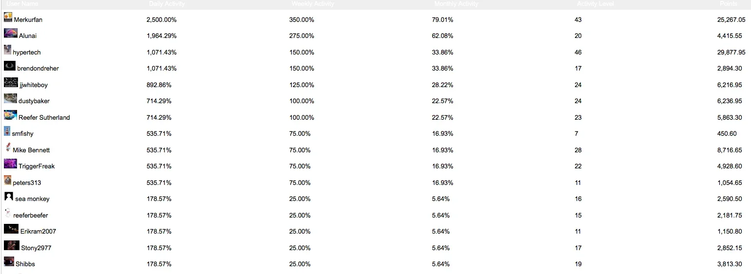

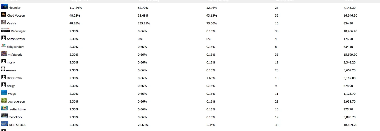

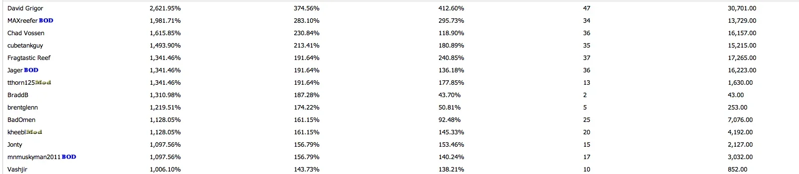

I have let it sit for a couple days now as you recommended but it seems not to even out. The calculation for those who were active works just fine but all the inactive ones have an issue. For example some who have the activity level of 2.30% even haven't been only for months or years.

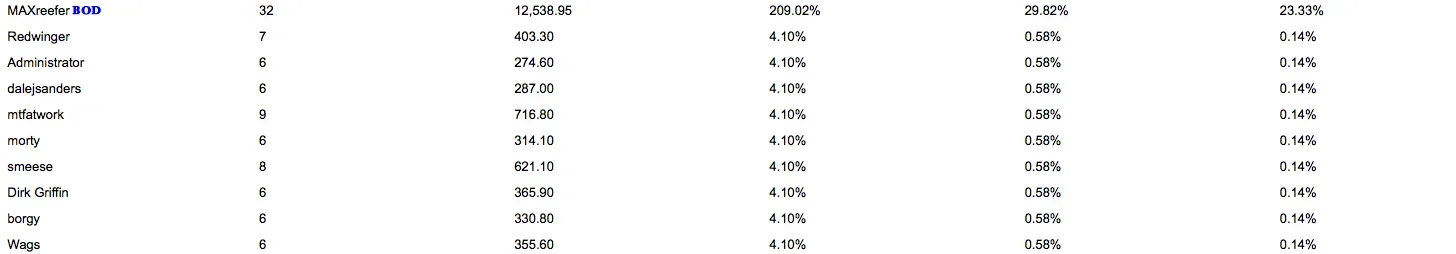

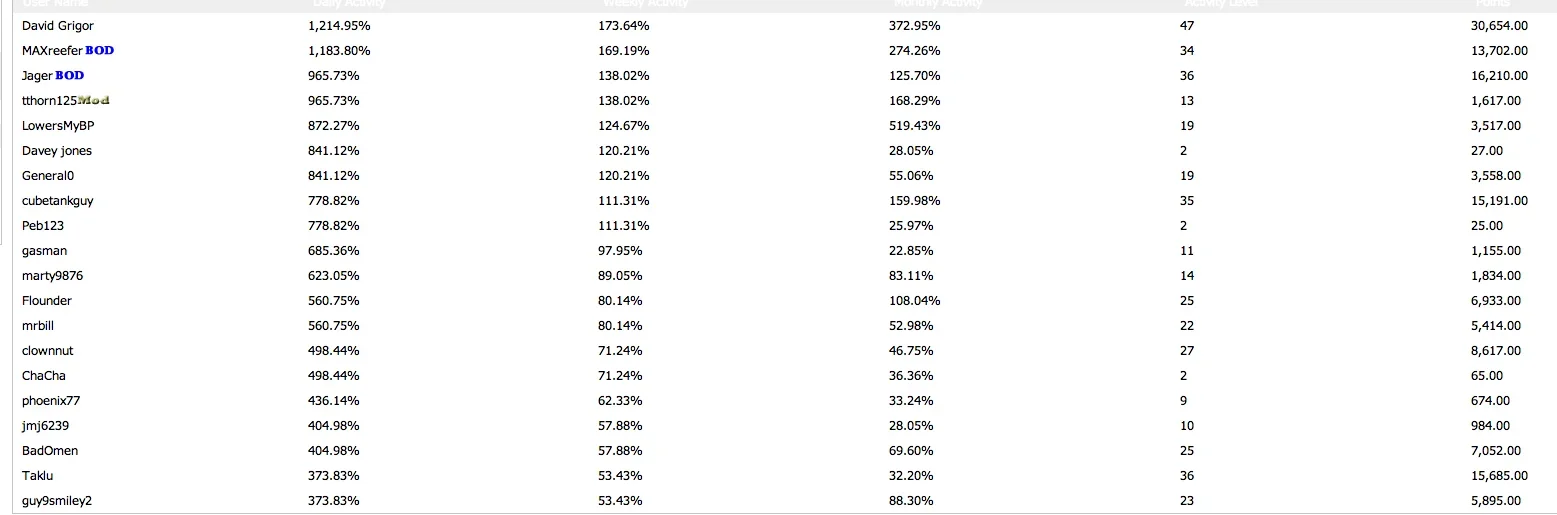

When I look at my own calculation it seems to be pretty accurate for the weekly/monthly activity but the daily one has the issue like anybody else.
Could it be one of the cron jobs do a wrong calculation for the "daily" calculations?

The 2.30% could be a result of "Points for Days Registered", which is added to every user regardless of their last active date.
If you have this enabled, this is 100% intended.

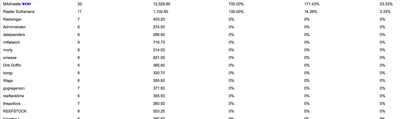

This is a screenshot from this morning. It is pretty much the same as it was last night before I went to bed (some users might have posted after I went to bed and got a few points extra since then. But for example myself (MAXreefer) I am still at the same % as last night.

Daily points got reset. All users have a minimal daily % because of the "days registered". I (maxreefer) posted yesterday something and I got reset also.
On my "live forum" where it is running in the background and where the "days registered" is NOT active the users who are active and posted something since I installed the MOD their daily % keeps growing and growing and didn't get reset. Those who were not active since I installed the MOD they got reset.
