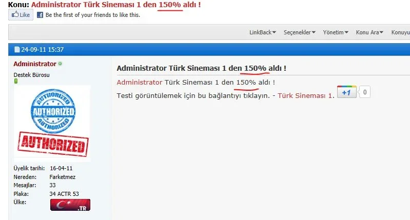

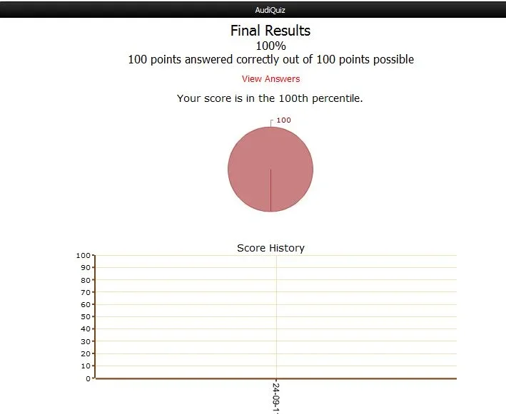

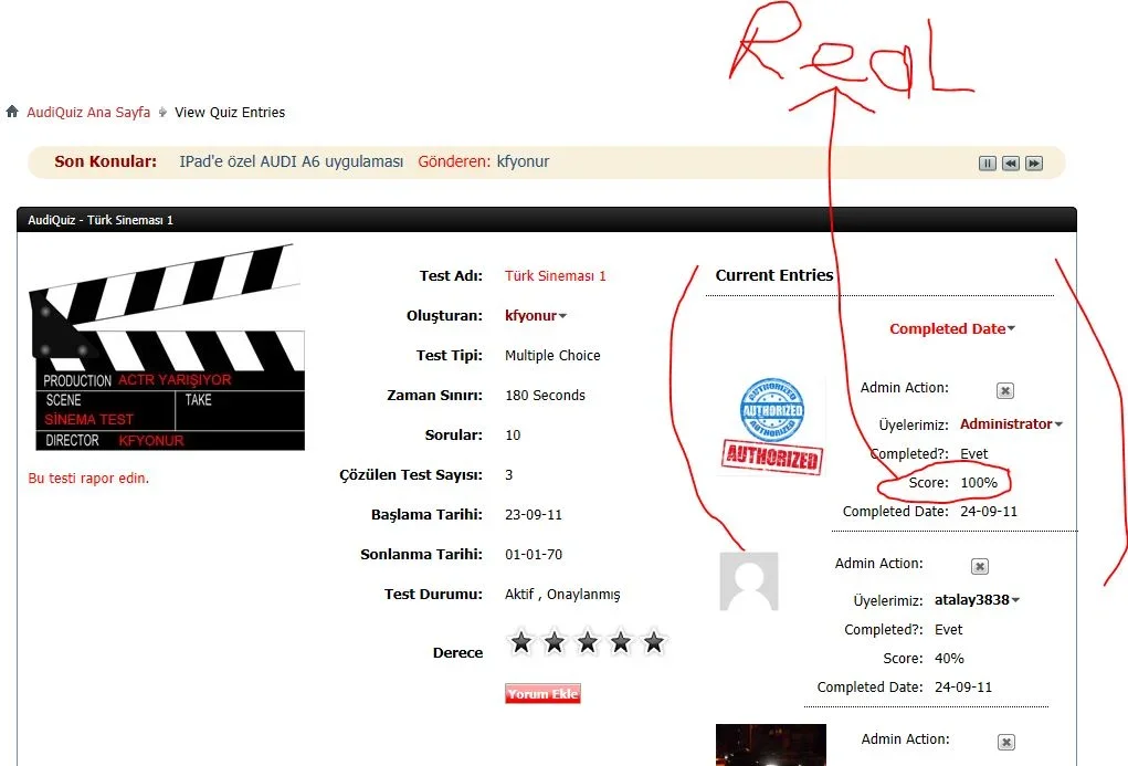

I was undecided to open a thread because my the other ticket is still open.My score system shows wrong score.
I took %100,system show points in Scored Quiz Submission Thread Subject more different..example %150 also test link in the thread subject didn't work.This problem has occurred new.

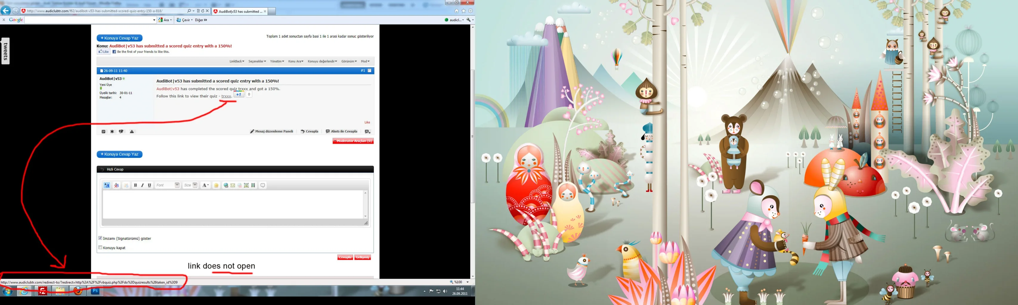

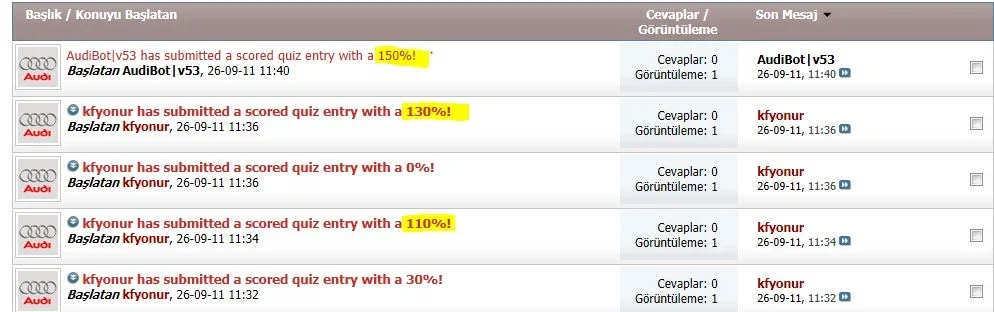

It's a different problem, new bug that came with the leaderboard additions and no one caught it yet.
I modified the file and uploaded it to your dbtech quiz directory. Can you try taking the quiz again and see if it creates the thread with the correct score now?

dylan this link is wrong and it couldn't open also i know the answer of this test and i solve it correctly but i couldn't take %100 points...10 question and 100 points (only this test)
bugs are attracting me:)
I have the link fixed. For some reason, if the quiz url is not filled out vB does some redirect code that messes it up. Only seen that happen on your site, maybe some other mod not agreeing with the local link. I fixed it and uploaded to your site. I can't replicate the wrong score problem. I tried 3 different quizzes and they all scored right. I would double check your correct answer selection for each of the questions/answers.
