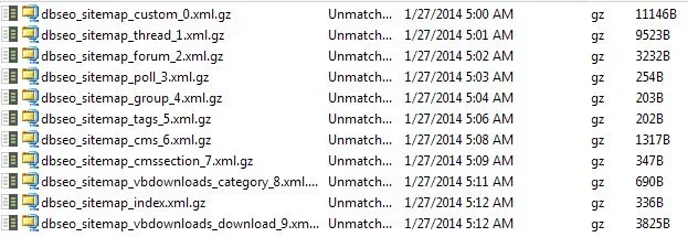

What I found interesting when checking the sitemap files that were created yesterday was the timestamps on them. The first one timestamped at 5:00AM as expected but the others (11 in total) were spread out between 5:00AM and 5:12AM. I found this odd for the sized site I have (pretty small). I know when I run the sitemap generation manually it runs in under 20 seconds (or use to a couple weeks ago, I have not run it manually recently). Just thought I would mention it, maybe you changed something in the coding to spread out the cron job?
Here are the times from yesterday:
