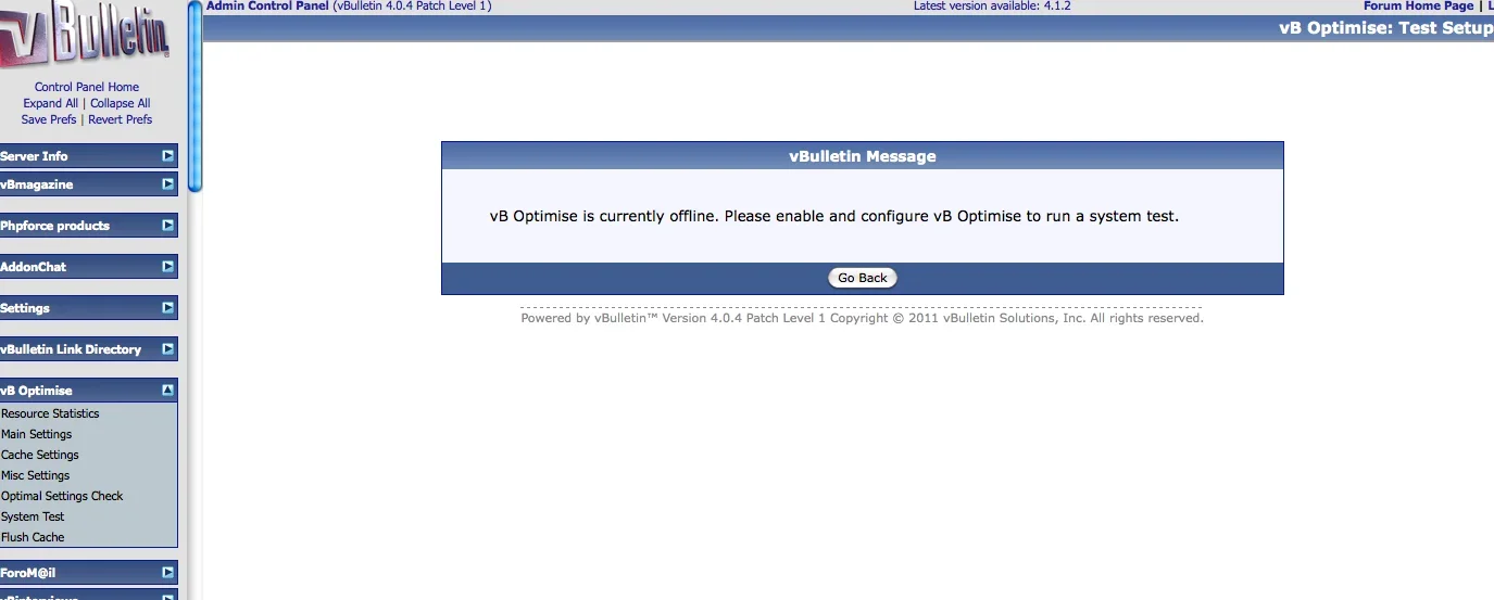

Ran SYSTEM TEST and receive this message:
vB Optimise is currently offline. Please enable and configure vB Optimise to run a system test.

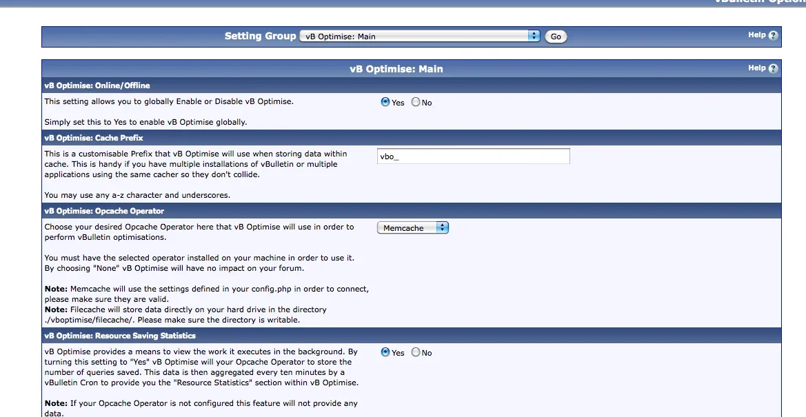

Could you ensure that, in the vBOptimise Main Settings, the online switch is set to Yes?
Absolutely it is ... ;)

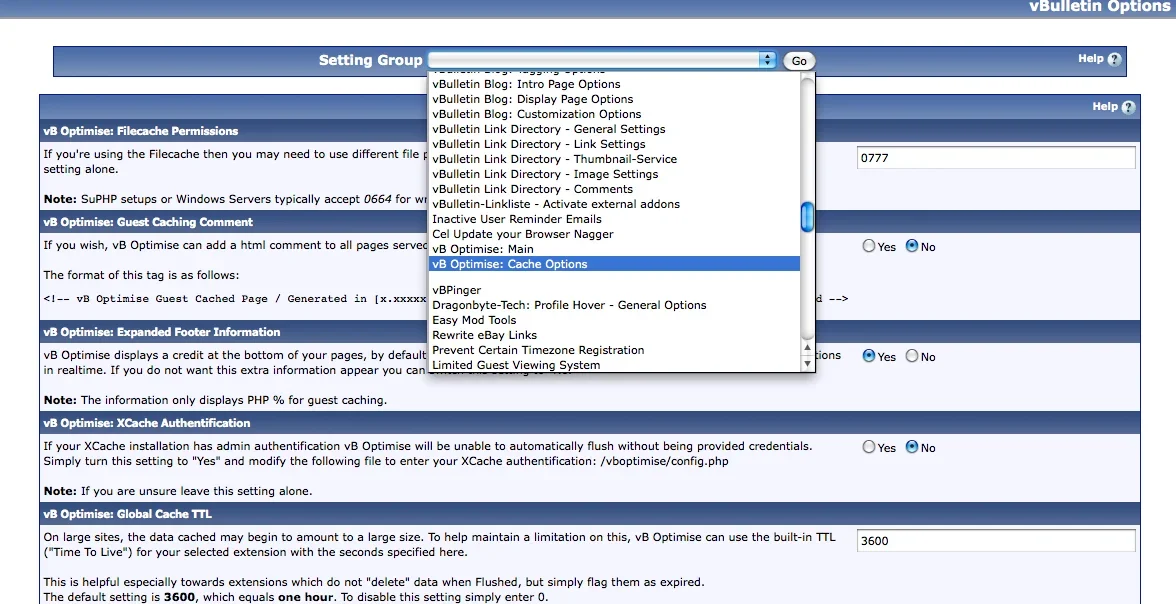

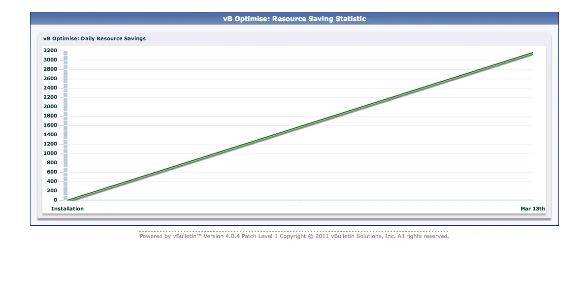

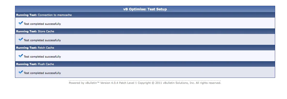

I also notice the the Main Cache Settings appears to have a second "blank" line under it when viewed through the vBulletin Settings drop-down box, although you can click on the blank line and it takes you to the Misc Settings screen.
Regards,
Doug

It just doesn't seem to recognize the ON setting with this PRO version whereas it did with the LITE version ...
Is there some manual way of turning it ON through a file somewhere?
Regards,
Doug

Could the product be disabled? Check the Product Manager and see if it's enabled there too.
I'll look into the phrase business :)
I've fixed the phrase issue, if you re-download and re-import the product XML the blank issue should be gone :)
Will do ... :)
Regards,
Doug
Edit: Problem fixed... no blank line any longer ...
