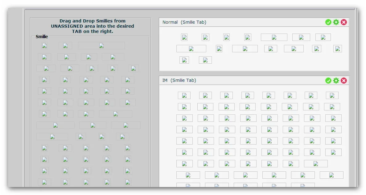

After performing some maintenance on my site, I noticed that all the smiley links are now broken. The links look like this:
/sims/http://www.simfansuk.com/sims/images/smilies/redface.png

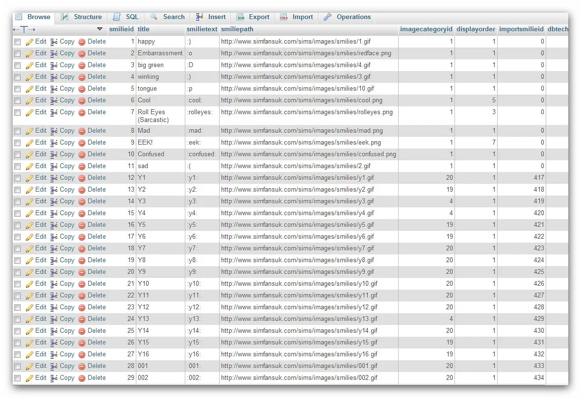

I've checked and re-checked the database and the links for the smileys are all correct.
What maintenance did you perform? I looks like the changes you previously made to the smilies in the DB (via Excel, from a week or so ago) have been overwritten, but vBET is still trying to reference the changed path.
With vBa Dynamics (again!), the smileys weren't showing in posts, though they were in the tabs. But the mod has an admin option to update the image links, so I did this. They are showing in posts now, just not in the tabs. I'm not sure how that would have affected the tabs mod as thought it only affected vBa Dynamics. I've searched through the database and all settings but can't figure it out.
