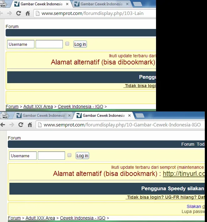

I use APC.
I notice a bug under certain condition :
1. Guest caching is on.
So when guest with *any* (default / mobile) style visit certain sub forum, it is opening another sub forum.
So in address bar the URL is correct, but what's displayed on browser is another sub forum.
For example i have 2 sub forums :
- sub forum A
- sub forum B.
Guest with mobile style visit A, on address bar it is A, but on browser it is B which is displayed.
If i turn off VBO completely, there is nothing wrong too.
This far i noticed 6 of my sub forums are displaying wrong.
I have fixed 1 of them by simply creating new sub forum and moving all threads from old sub forum to new sub forum
Ok after observing a little bit more i find some interesting pattern.
So these are sub forums which are displayed wrong on mobile guest :
- Sub forum ID : 102 >> displaying sub forum 10
- Sub forum ID : 103 >> displaying sub forum 10
- Sub forum ID : 112 >> displaying sub forum 11
10 & 11 are the most visited sub forum by guests.
So it seems VBO picked up the wrong sub forum ID?
I use URL pattern like this :
It is just a default one (no vb seo / any seo plugin)
More update :
Sometimes refreshing fixes the issue.
Maybe there is a kind of race condition issue?
I also noticed that my forum id 28 is showing forum id 2.
Can someone check this bug? [MENTIONS=Fillip H.][/MENTIONS]
