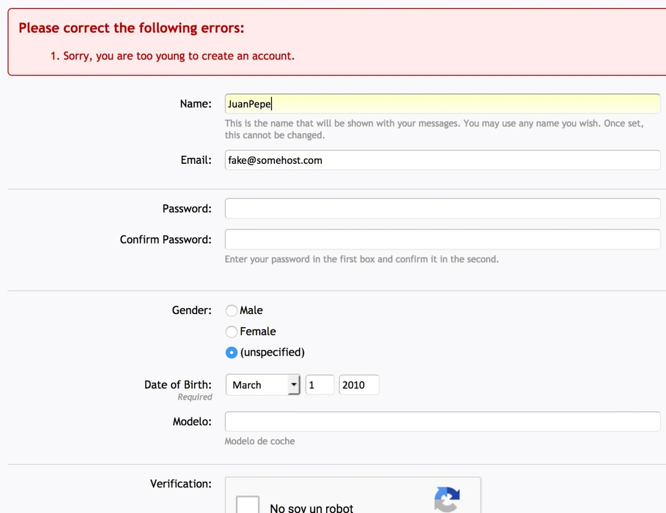

The problem is if i try to register and the form have any error, the next time the date is cached and can't register again (attached images with to young to register)
First time that try to signup with 2010 of year of birth

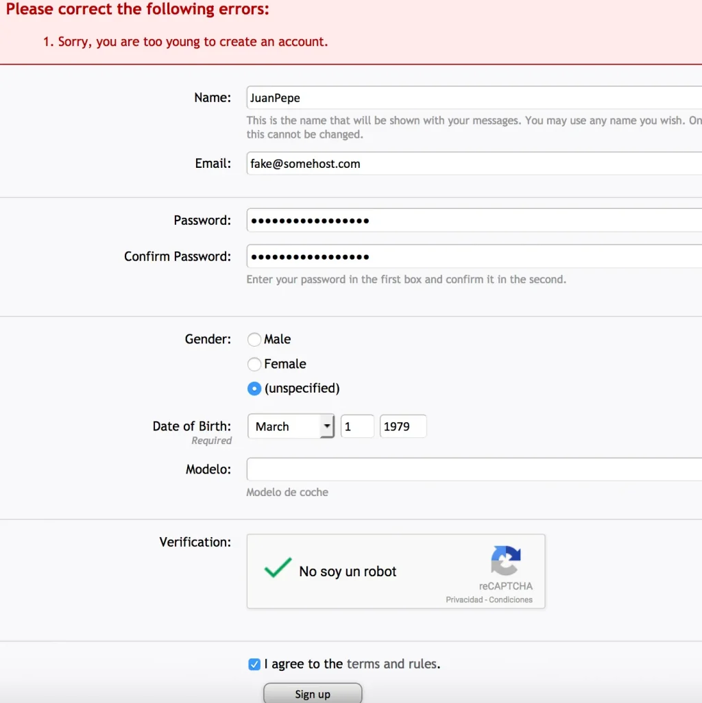

Second time with 1979 year (correct registration)

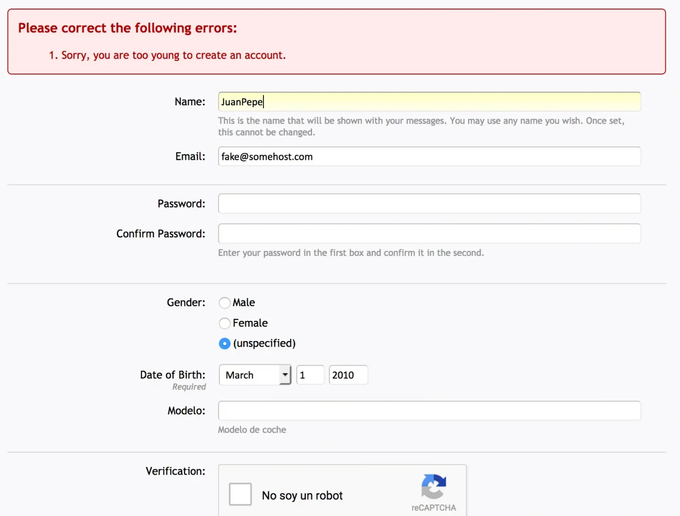

The form get error and i have my date cached from first attempt 2010
