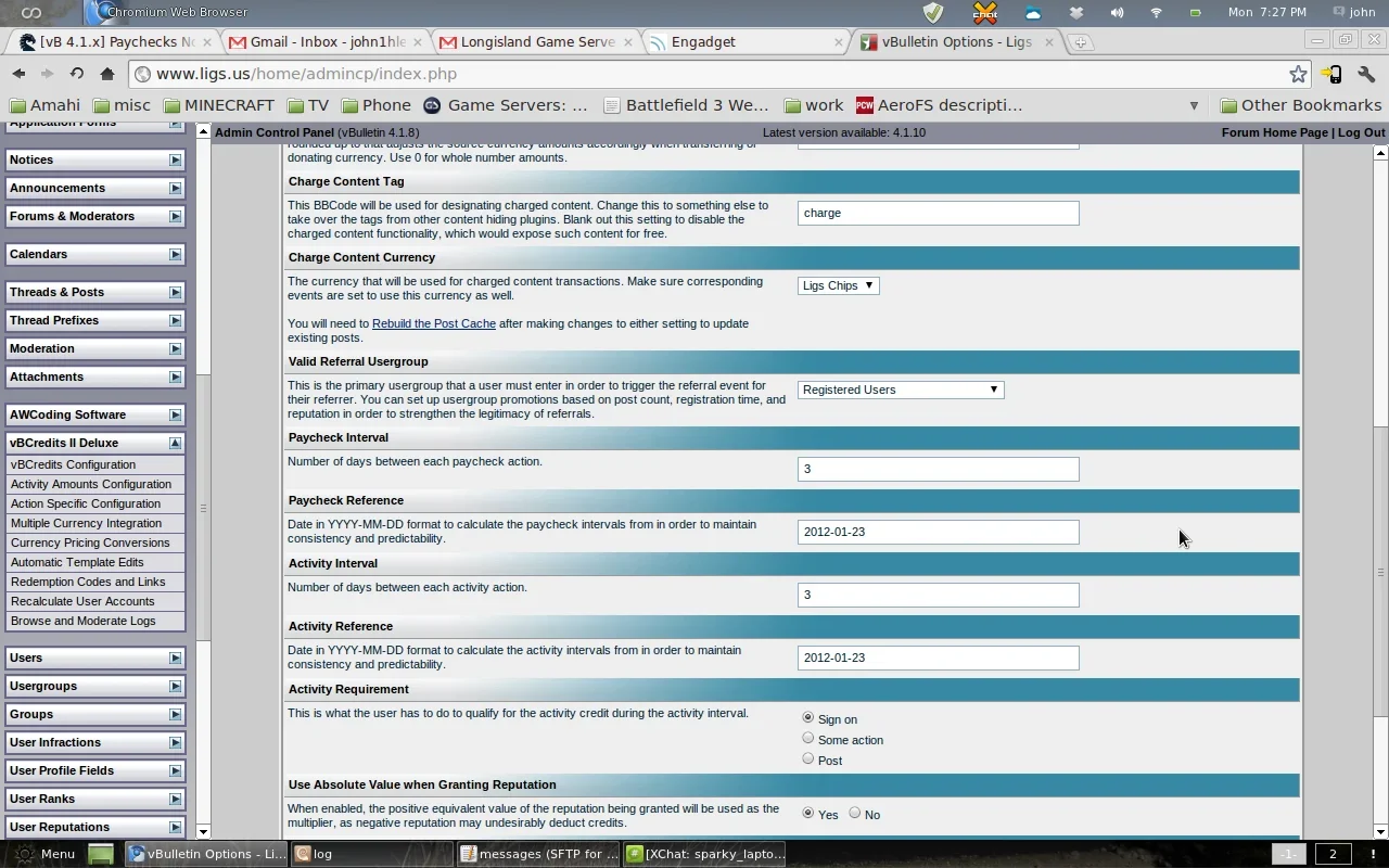

It is very frustrating trying to get the paycheck system to work correctly. Out of 75 members only 11 people have gotten their pay checks. One member received 11 pay checks in 2 minute. I have been testing the system for about 3 weeks with different settings and can not get it to hand out pay checks consistently.
Update. It just gave another member 5,121,000 2000 at a time. He has not logged in for a long time. This is my settings. I only want to give pay checks and awards moving forward. I still have not received my paycheck.
Screenshot at 2012-01-23 19:27:18.webp
Well a member just go 4000000 in paychecks I have still not received 1. It seems to be totally random and working correctly. If my paychecks cant be worked out I would like to please have my money back.

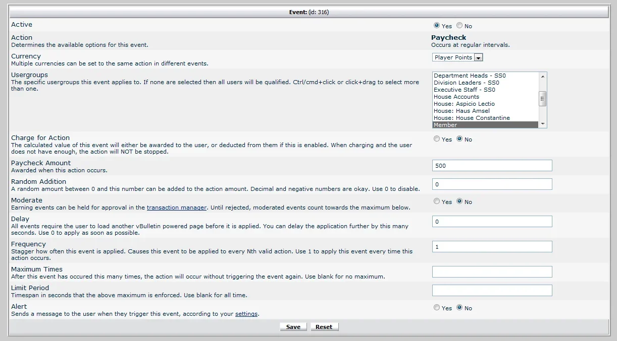

Can you show me a screenshot of your current paycheck event? It runs through every user. If its able to work on birthdays, then it must have attempted to do paychecks but the event didn't handle it.
Here it is. Two weeks ago I merged one credit into the other (I had two set up in VbCredits and merged one into the other) and it hasn't sent out a paycheck at all since then, even though it is sending out birthdays.
