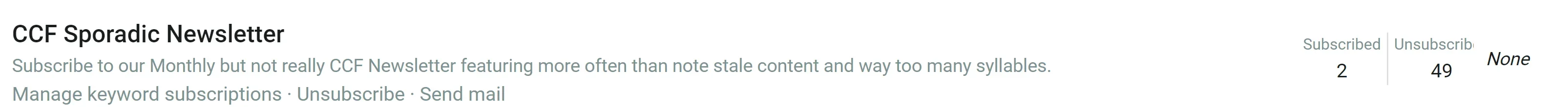

So I created a test mailing list newsletter, I did not auto subscribe anyone yet I have 49 unsubscribed. I only subscribed 2 test users. How are these people unsubscribing if they're not subscribed from a newsletter that was never sent?
"Not subscribed" is not the same as "Unsubscribed".

Right but they're showing in the subscription log as unsubscribing to a newsletter that was never sent and they were never autosubscribed to on paper. I'm totally confused as you can tell :) Could these in fact be inactivity digest unsubscriptions being incorrectly flagged?
No, this is not an issue I am able to replicate. There is nothing unsubscribing users to a newly created mailing list.

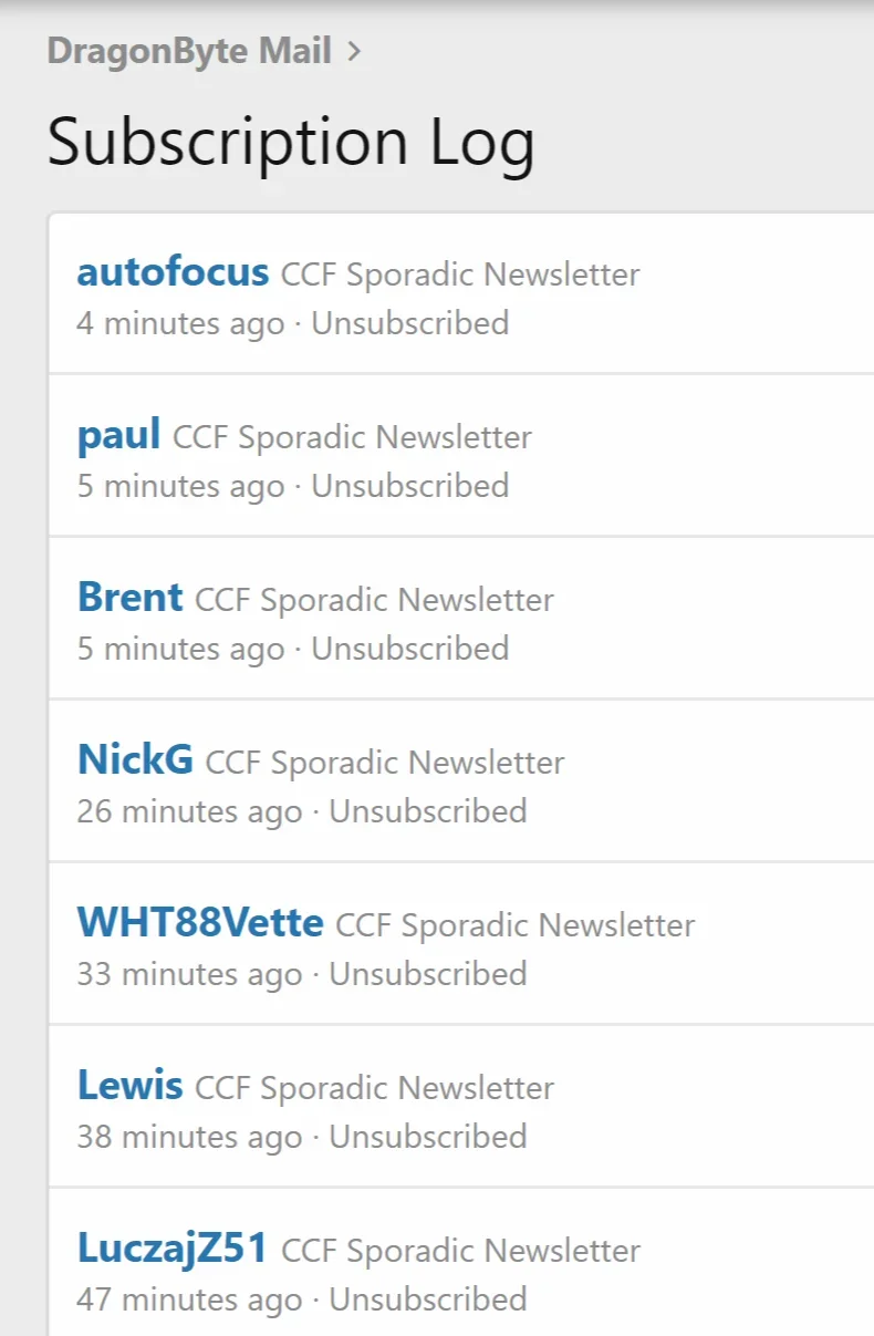

Here's what I see in my subscription log. I see a bunch of users shown as unsubscribed from a Newsletter that they were never subscribed to and was never sent and is inactive. One thing I notice is that all users are inactive and the only thing I have running from a DB Mail perspective is the inactivity digest (main digest is disabled at the moment). If you consider that normal then so be it but to me it's not and looks like a bug with the inactivity digest unsubscribe action being logged under a different event.

Digest unsubscribes aren't logged, so no.
Is the ID of this mailing list 1? If not, then even if digest unsubscribes were logged, it couldn't be from this.
Actually I've just had a realisation, this could happen if someone clicks "Stop all email from siteName" when unsubscribing from any email.
The EmailStop feature in XF2 allows you to one-click unsubscribe from all possible email and if this happens, they are logged as unsubscribed from all mailing lists too.

Riiiight, that makes sense now. And yes ID of mailing list above is 1.
Okay, I guess. You're still logging unsubscribed to a list that isn't active but I guess that's a byproduct or can that be logged differently somehow. It's somewhat misleading right now though one could argue also accurate.
The reason why they are logged in that way is because the system needs a way to detect that they have opted out, so that if later you decide to rebuild default subscribed, we are not violating their notification that they do not wish to receive email.
