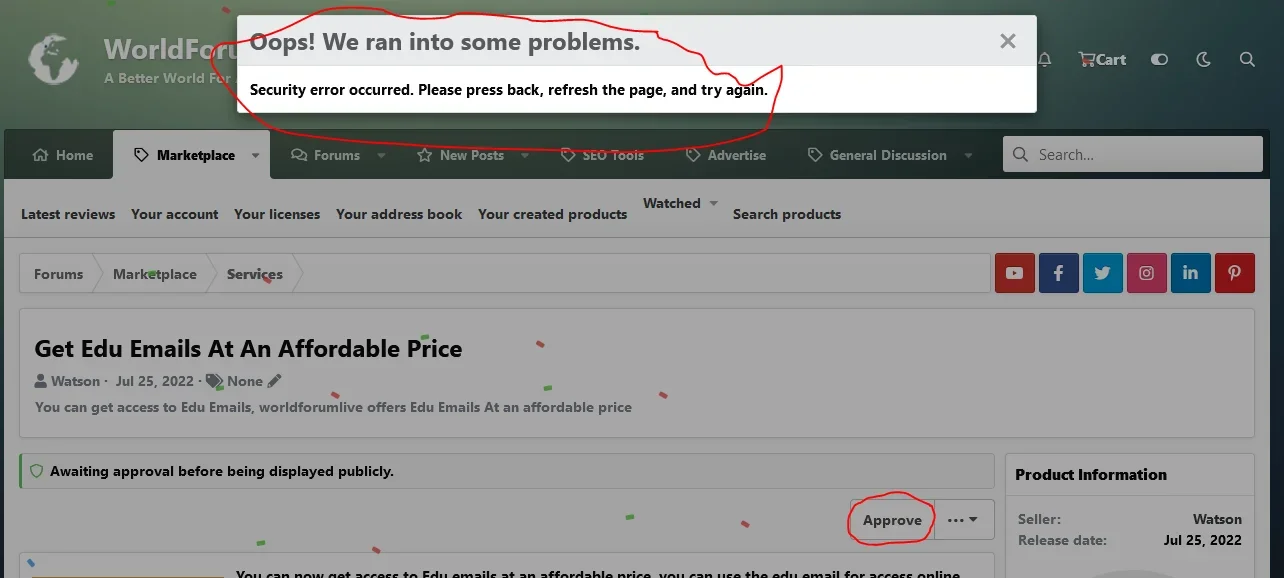

We are still unable to use DragonByte eCommerce 3.0.0 as we keep getting the following error code each time we try to approve A Shop Post
An attached image is added here . while below is the error code we use to get
[ Oops! We ran into some problems.
Security error occurred. Please press back, refresh the page, and try again.]

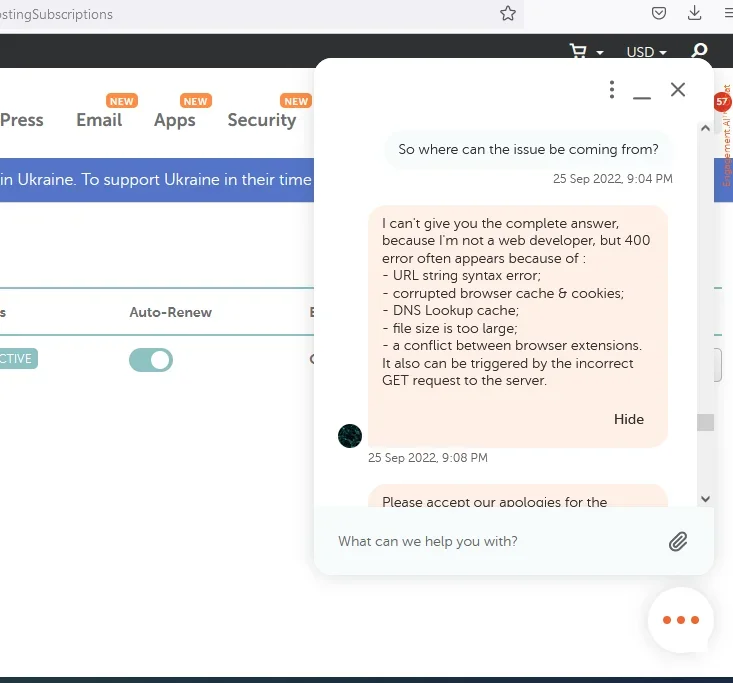

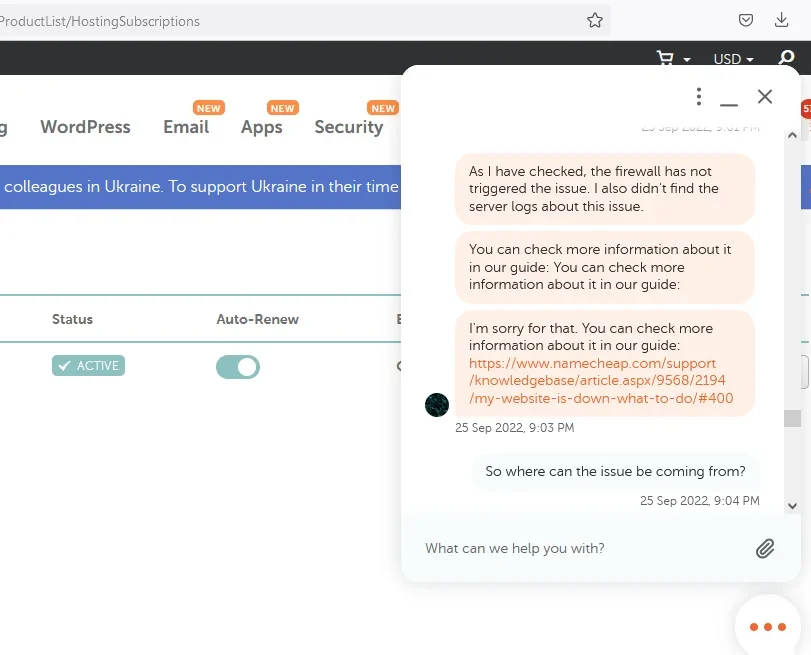

Because of this, we have contacted our host which is Namecheap for now and they have also read and ended up letting us know the issues is not coming from them the host
Below are attachment, we got from them
Please how can I get this resolved as we have not been able to use this since we purchased it?
That is likely an error in your browser, as suggested by the Namecheap support agent.

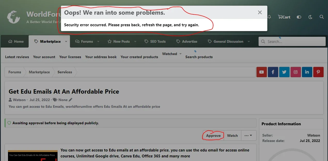

Please this is something I have tried for months from more different browers
and am still getting the same error
Just cleared all caches and tried again with both compueter borwers and my mobile phone browser with the same results
Please I Need help here as i have not been able to use the plugin
This issue does not prevent you from using the plugin. You can approve the item from the Approval Queue, or by using the "select for inline moderation" item and using that to approve the item.
That being said, I do see the issue now and I'll fix it for the next version.
