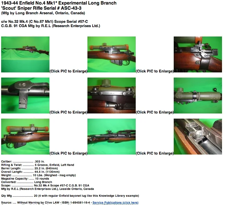

Just sent a another test email and it worked GREAT !!!

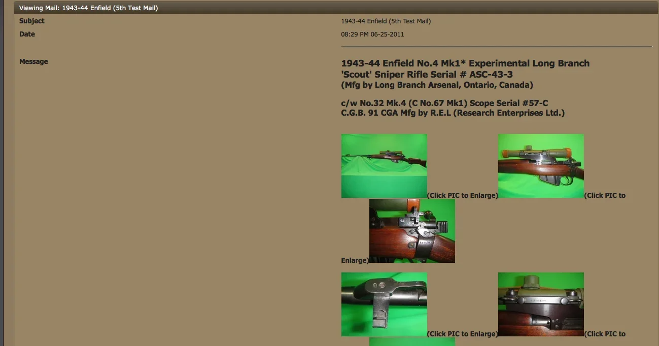

Imbedded pics appear within email and if clicked on, they open up into full size ... (see attached BOTTOM pic to see what email user sees when he receives it)
Thanks... makes a huge difference for the kind of creativity we would use the emails for in sending out updates for our collector community .. very slick with the graphics capability ....
Note: the history view from the web site still seems to push everything to the extreme right (see attached TOP pic)... :confused:

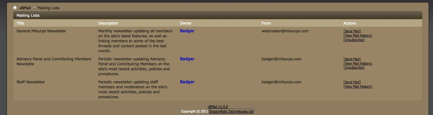

A few more questions as we prepare to go "live" with multiple email styled newsletters for different audiences (user groups) .. see attached pic...
1. If a user is a member of a user group (ie: Contributing Member) that is automatically subscribed, but subsequently they lose that status and just become standard registered members because their donation expired and that usergroup check mark is removed in their user record, do they also get automatically unsubscribed by vbMail?
2. If a user is banned or deleted from the site, do they also get automatically unsubscribed by vbMail?
3. Has the ability to prevent a user, who is not subscribed to one of the email groups we've set-up shown in the pic attached, from view the stored email history, been added to vbMail? We wouldn't want standard registered members reading Moderator email histories etc.
4. Can we get the ability to delete OLD entries in the email histories?
Thanks for your efforts... :)
Regards,
Doug
1. No
2. Not currently, but I'll add that for Final :)
3. That will also be added for Final.
4. This probably won't make it for Final, but it should get added in one of the future updates :)

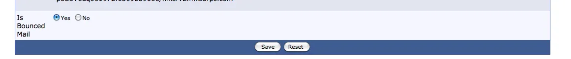

Finally, there's an option at the bottom of a bounced email that appears when viewing any entry in the Bounced Email List option. (see pic)
I'm not sure what it means and how (or when) I'd choose these options?

They will be able to go subscribe manually. You'd need to remove them manually as well, there's sadly no way of automatically unsubscribing them.
If the system incorrectly tracked an email as a bounced mail, but the contents says it's an autoresponder or something, you have the option of un-flagging it :)
Roger that ... :)
Kind of like the "this is not junk mail" option when you see something in the spam box that shouldn't be there ...
